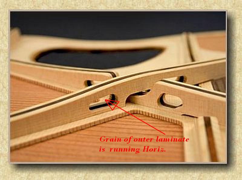

OK, a comment about Shan'es Moral stance on not wasting the great resources that the Lutz trees are struck me.......
coupled with the fact that I'm tighter than a duck's behind......
Has anyone other than McPherson tried Laminated braces?
surely all those offcuts from the edges of soundboards should be used.......
lammed up to make braces.......
McPherson bracing link.....
or am I talking rubbish again?

OKaaaay then,
are we cutting three 1/4" strips off the outside on the jointed top, sandwiching them, then turning them 90 degrees so the lams are vertical like the McPherson?
or should there be some change in grain in the middle lam rather than having tham all parallel?
PostPosted: Thu Sep 06, 2007 3:55 am
I assume you plan to CF for the middle lamentate. I would want the grain of the CF running just as you would if it was a non laminated spruce brace. This would be perpendicular to outer laminate. Just as shown in the McPherson photo. The stiffness of the brace is now coming from the CF.
PostPosted: Thu Sep 06, 2007 4:00 am
If not using CF for center laminate the you still would want the center laminate grain to run perpendicular to the outer laminate

Not if you are using top cut offs as shown in the Mcpherson photo. If you are using brace stock for the outer laminate the yes the would be parallel.

Now I'm confused. It looks to me like all the grain in the photo is going horizontally, just like a normal brace. Are we looking at the same photo?
Bob Garrish
PostPosted: Thu Sep 06, 2007 6:04 am
Look again Bob .. thru the cutout in the overlapping brace ..the grain line runs thru the cut PARALLEL to the top - its a flatsawn section - we use braces oriented for quarter. These are top cutoffs turned on their sides - thats now a flatsawn piece. They need the centre lam to give these strength - or keep them taller as well, as its obviously the worst orintation to get strength out of spruce.

Humm?????? I believe they are using Rosewood for the center laminate not CF. There whent the weight savings

I'm doing the 'Mario Thing' on my next guitar, namely laminating (like that picture) a 0.02" sheet of unidirectional CF between two strips of (traditionally grain-aligned) Adi spruce. A cap will add more stiffness, I'm sure, but I'm doing it to decrease the spruce's memory effect more than anything else, at a minimal increase in mass that should be easily compensated by a little carving (should it be necessary). I like how wood looks, how wood instruments sound, and I'm not trying to go full-on innovation style (I'll let folks like Rick Turner trailblaze while I figure out slightly more 'basic' things), but decreased memory's a plus. Mario's description (it's in the MIMF library) of 'abusing' various scraps of spruce brace stock with and without CF by hanging weights, exposure to heat, humidity, etc., and the increased resilience (springing back into shape isntead of taking a set) of the laminated bits pretty much convinced me to give it a shot. Have a small section of laminated stock I've hung a little weight on as well as a control. Only had it for a few months now, but the results are much like Mario's.

Arg, you're totally right (Tony and Mike). For some reason I was interpreting the statement as implying the center lam should be set in as all short grain, like one would do when laminating sides together, and it just made no sense. Too many perpendiculars in three dimensions.
